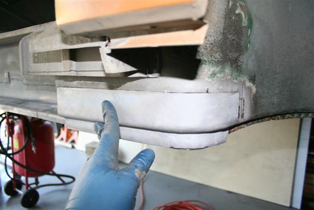

Next I fabricated this piece. As you can see it is part of the front fender well as well as the base for what the front of the outer longitudinal welds onto. I just need to drill holes in the bottom for the rosette welds and then butt weld the top and side.
I don't have photos, but I also refurbished the front and rear metal pipes for the heater tube. That is about as far as I got last week. Next steps are...

Richard Casto   Next I fabricated this piece. As you can see it...   Jul 22 2008, 09:58 PM

Richard Casto   All welded on. Fabrication takes a lot of...   Mar 31 2009, 07:29 PM
Richard Casto   Just need to grind down the welds and add in the...   Mar 31 2009, 07:35 PM
Richard Casto   About 1/2 done with my welding. While the c...   Mar 31 2009, 07:41 PM
Richard Casto   Mostly welded and about 90% ground down. Just m...   Mar 31 2009, 07:46 PM
Richard Casto   Well that is it for now. I am going to continue t...   Mar 31 2009, 07:50 PM
