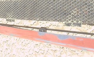

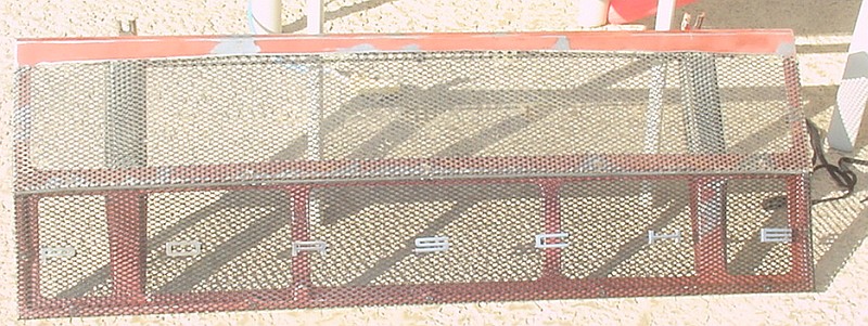

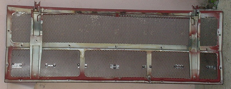

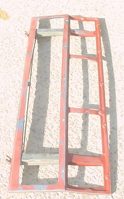

Now I know why GT grills are so expensive...they're a lot of work to put together. After looking at Eric Shea's thread, Pelican's, and a few examples of others who bought or are making them, I said to myself "I can do that!"
I tried to incorporate the ideas that I liked and went off on my own to make my own version of the GT grill. Even though they all look similar from 3' they're not...look close.
Here's my almost finished product. It still needs painting and trim beads on both grills. The grills are not attached yet...
I'll post the painted version tomorrow...hopefully.
Here is the frame with rounded corners...hopefully to reduce stress cracks.

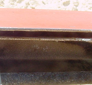

To secure the back on the second grill, I welded in a 1" X 18" strip on the underside of the grill and made tabs on the grill by flattening a few areas. The tabs slide into the space between the braces and the strip that I made. No fasterners are needed. The front is secured by the pins of the first grill and a couple of the pins going from the top and side.
You're looking at the small lip welded on the underside.
