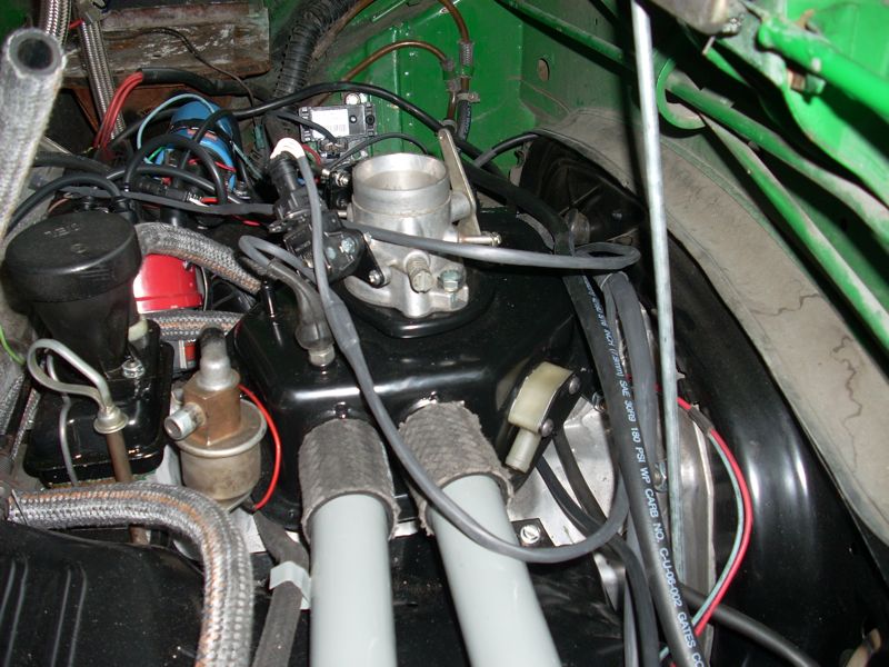

Here are some more pictures of the installation as it progresses.

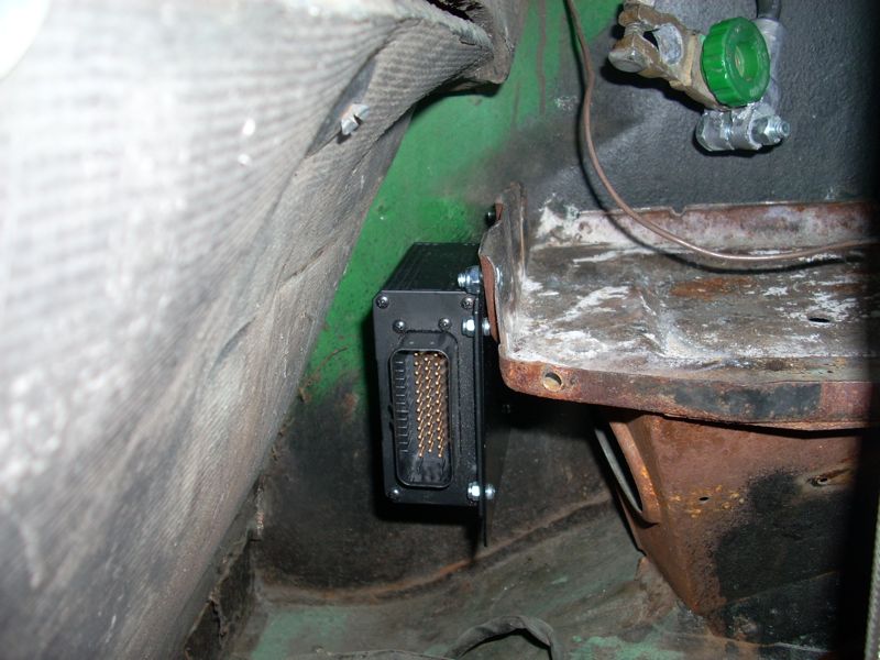

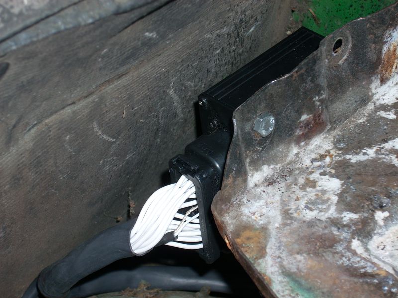

Here is the ECU mount. I forgot to take a picture of the mounting plate. It's a 5" x 5" square with two holes at the top to mount to the battery tray and four holes halfway down to mount the ECU. Nothing fancy.

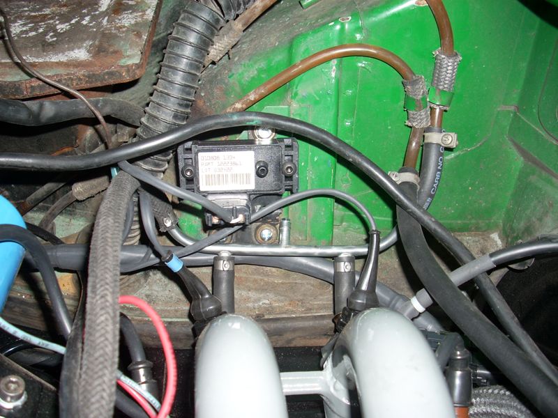

McMark   Brain will be in the stock location. MAP sensor ...   Jul 20 2008, 09:17 PM

TimT   I happen to have the engine of my car out while I ...   Jul 22 2008, 07:08 PM
TimT   In this pic you can see the TPS, IAT, CAS, and if ...   Jul 22 2008, 07:09 PM
McMark   No problem. All good info. :thumbsup: I have mo...   Jul 22 2008, 11:53 PM

smdubovsky   The microsquirt uses ampseal(?) connectors. We us...   Jul 24 2008, 12:12 PM
McMark   Here's the picture of the AMPSEAL connector. ...   Jul 24 2008, 07:53 PM
