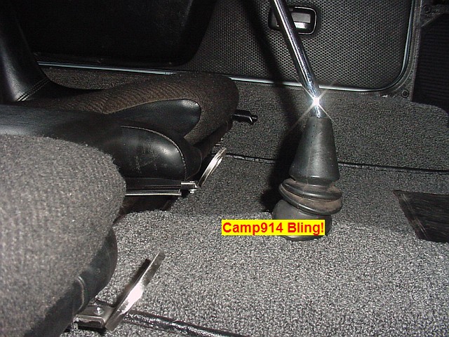

Added some Camp914 bling to the cabin today...Craig's replacement seat handles. If have your seats out...do yourself a favor and pickup a set of these from Craig. You won't regret it.
