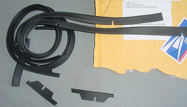

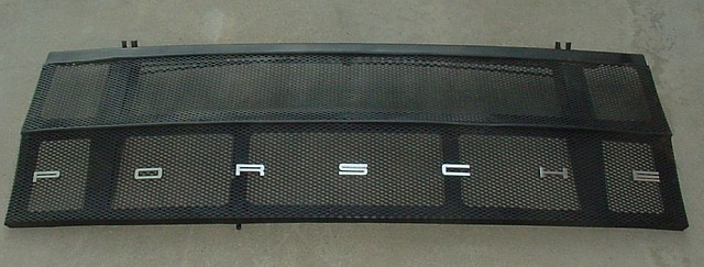

Also in the mail today from Craig, came the beading I needed to assemble my GT grill...ony available at Camp914. All in all, the grill came out pretty decent. Next time, should be a lot easier. (IMG:style_emoticons/default/laugh.gif)
The final product.... (IMG:style_emoticons/default/smilie_pokal.gif)
