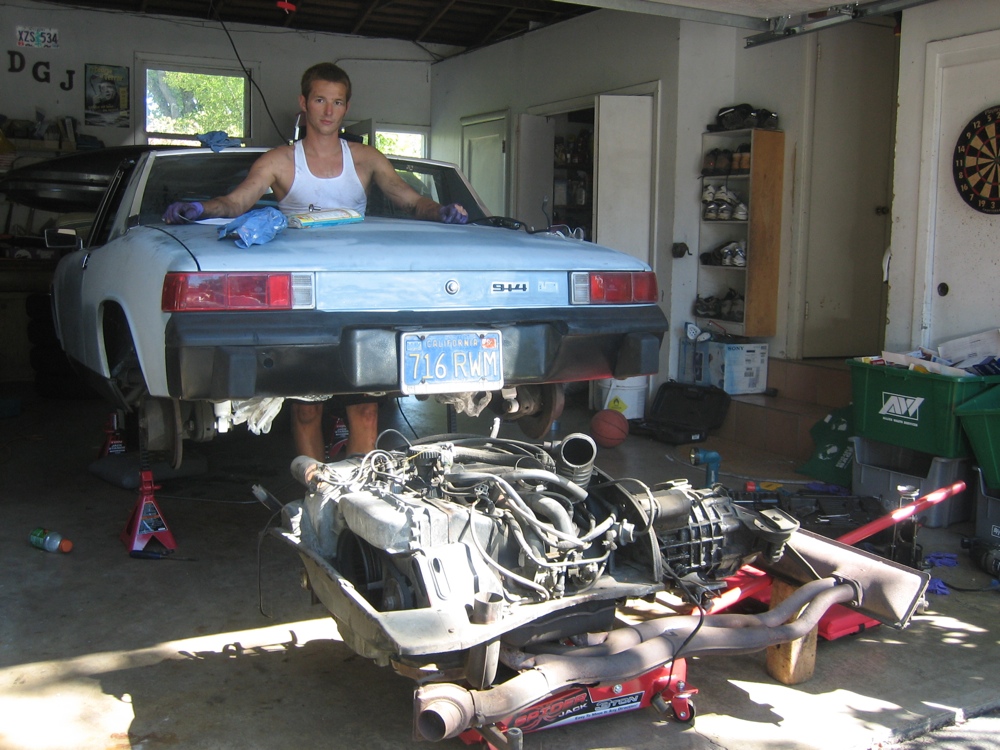

malaga_red75   Engine is out! will post pics later -peter   Jul 26 2008, 09:27 PM

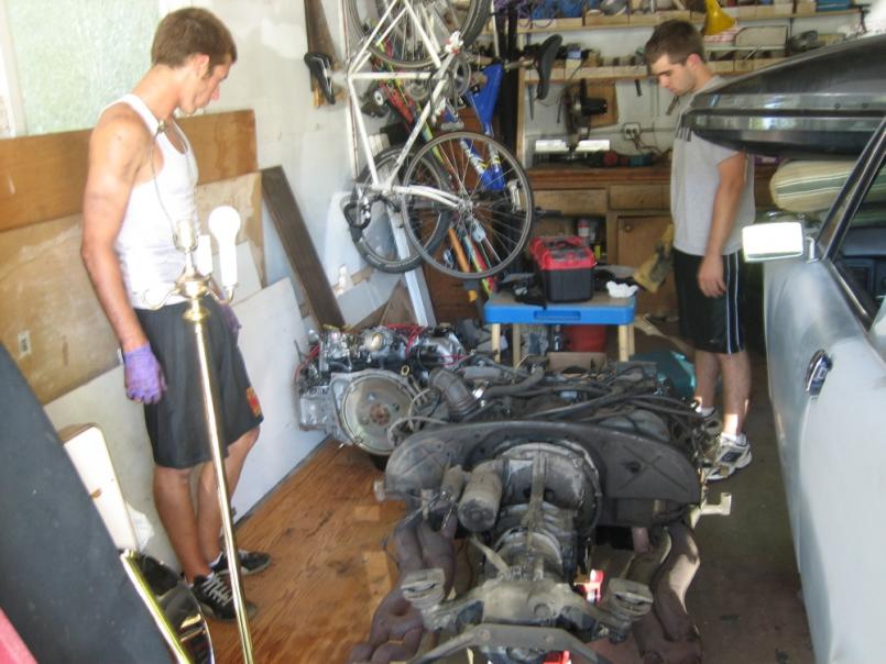

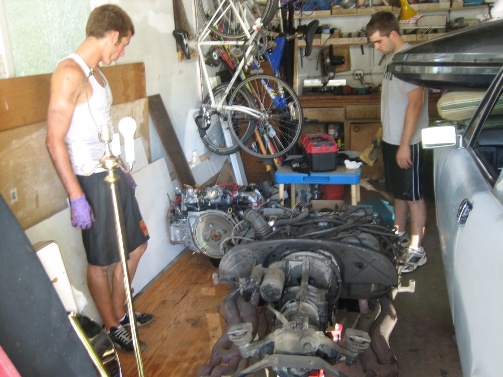

malaga_red75   So, updates for the weekend -the engine is out...   Jul 28 2008, 01:43 AM
malaga_red75   coming out...   Jul 28 2008, 01:44 AM
malaga_red75   ...   Jul 28 2008, 01:44 AM
malaga_red75   ...   Jul 28 2008, 01:45 AM
