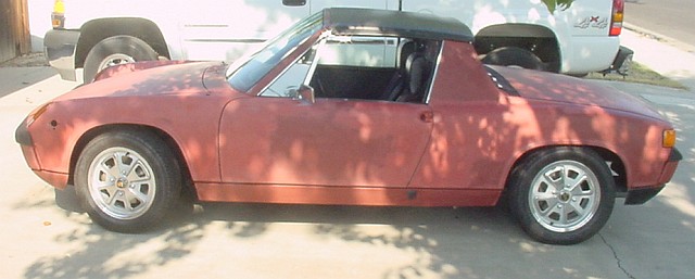

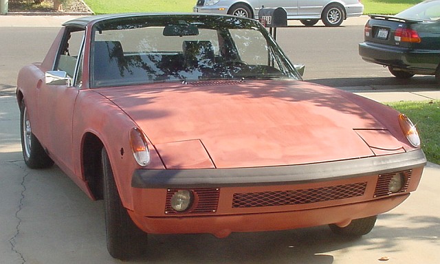

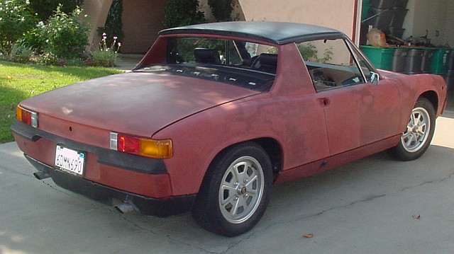

Edited.....thought I would add some before and a after picture since this thread has evolved into a v-8 install/restore/modify thread. The story begins....

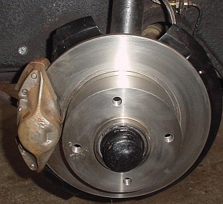

Thanks to Nick, his almost new BMW front calipers arrived yesterday. I added a 19mm MC along with some Porterfield pads to go with them. It took a lot of bleeding to get all the air out of the system, but at last...a hard firm peddle. And...they stop great, you would never know the car is carying the extra weight.
Had to drill out 1/2 of the floor pan welded nuts that hold the bottom part of the rockers on. Installed new t-nuts and checked the rockers for fitment.
