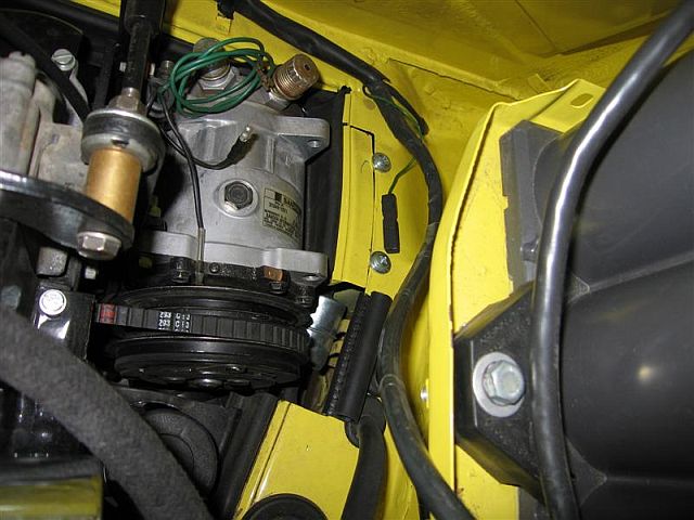

Here's one install...not mine. I've seen it done without cutting the shelf as well.

Here's another link I got for a York to Sanden bracket from a Mercedes site I visit, you may check with this company about it:
