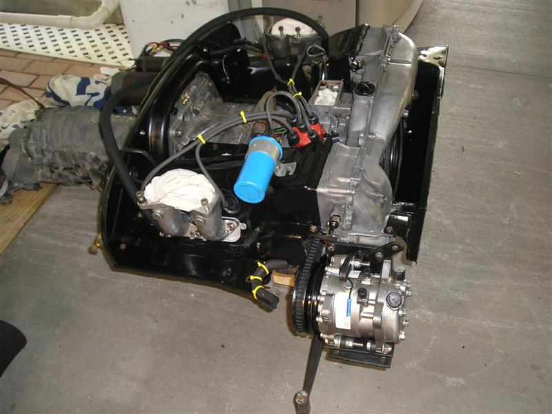

Hey guys & gals,
The York compressor in my '73 2.0 has finally died. I have already changed out the hoses previously to "barrier?" hoses which run 134a freon. I can get another rebuilt York I suppose, but I have heard of rotary compressors working better and using less hp to run. Has anyone already made the changeover? Are there any rotary compressors that fit properly? Do I need mounting brackets?
Any info would be greatly appreciated. I live in So. Cal and gas is $4.65 as of today, which means the 914 will be on the road more than the F-150. And it's getting hot here!
Scott

Photo of same brackets and Sanden 505:

computers4kids   I bought a new Sanden508 off an ebay auction that ...   Jun 12 2008, 08:36 PM

maf914   The adapter bracket in Computers4kids post is avai...   Jun 18 2008, 09:52 AM
computers4kids   The adapter bracket in Computers4kids post is ava...   Jun 18 2008, 10:54 AM
JmuRiz   [quote name='maf914' post='1046444' date='Jun 18 ...   Jul 30 2008, 04:07 PM
maf914   Mark, Thanks for the photo. Looks like the engin...   Jun 20 2008, 08:26 AM
thomasotten   Is this adapter all that is needed to bolt to the ...   Jul 30 2008, 01:24 PM
computers4kids   Is this adapter all that is needed to bolt to the...   Jul 30 2008, 01:37 PM
southernmost914   Photo of same brackets and Sanden 505: attachmenti...   Jul 30 2008, 06:34 PM
