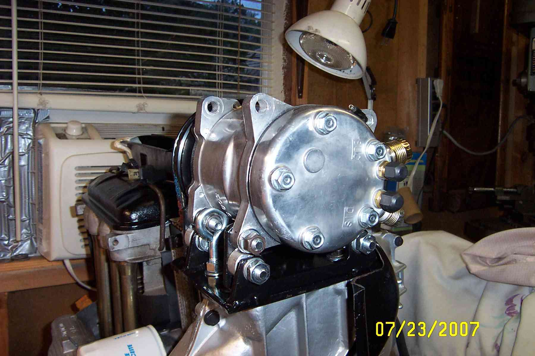

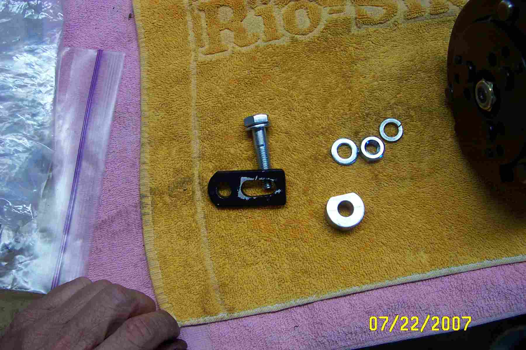

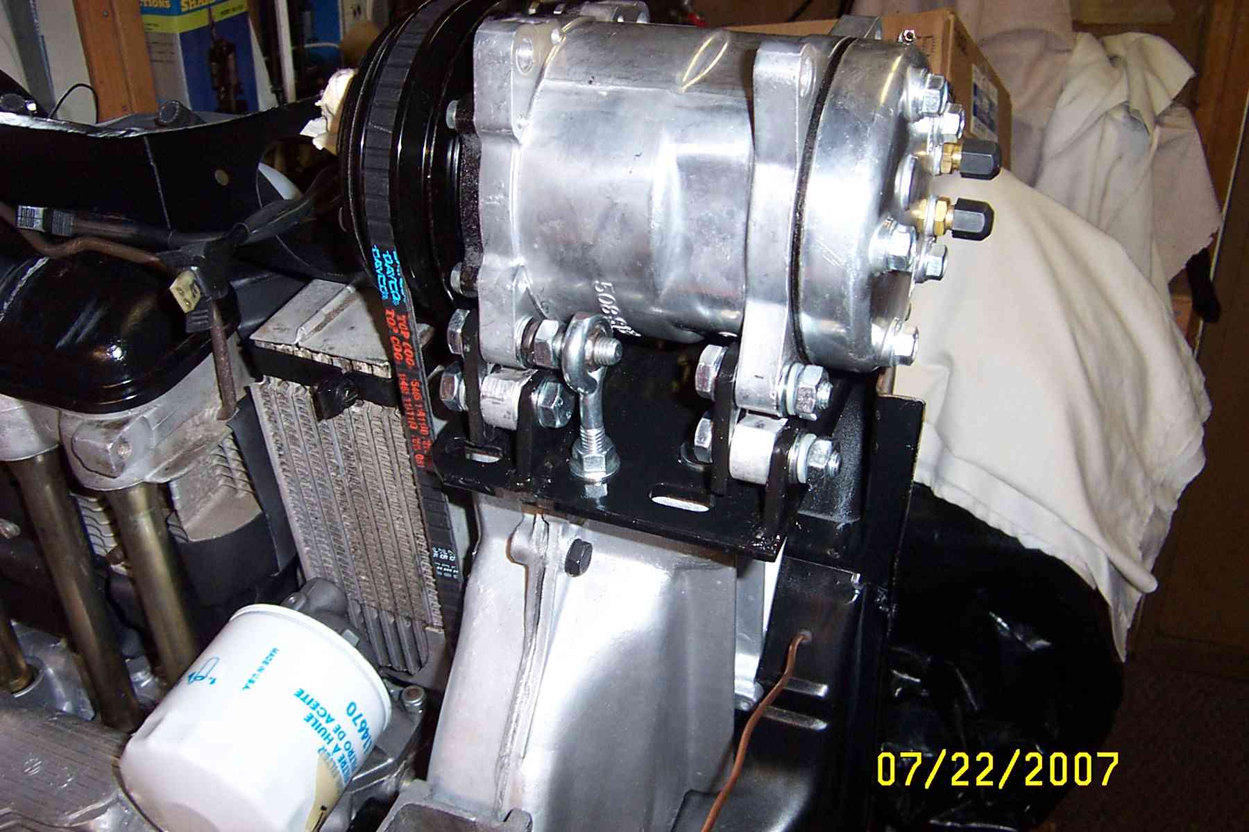

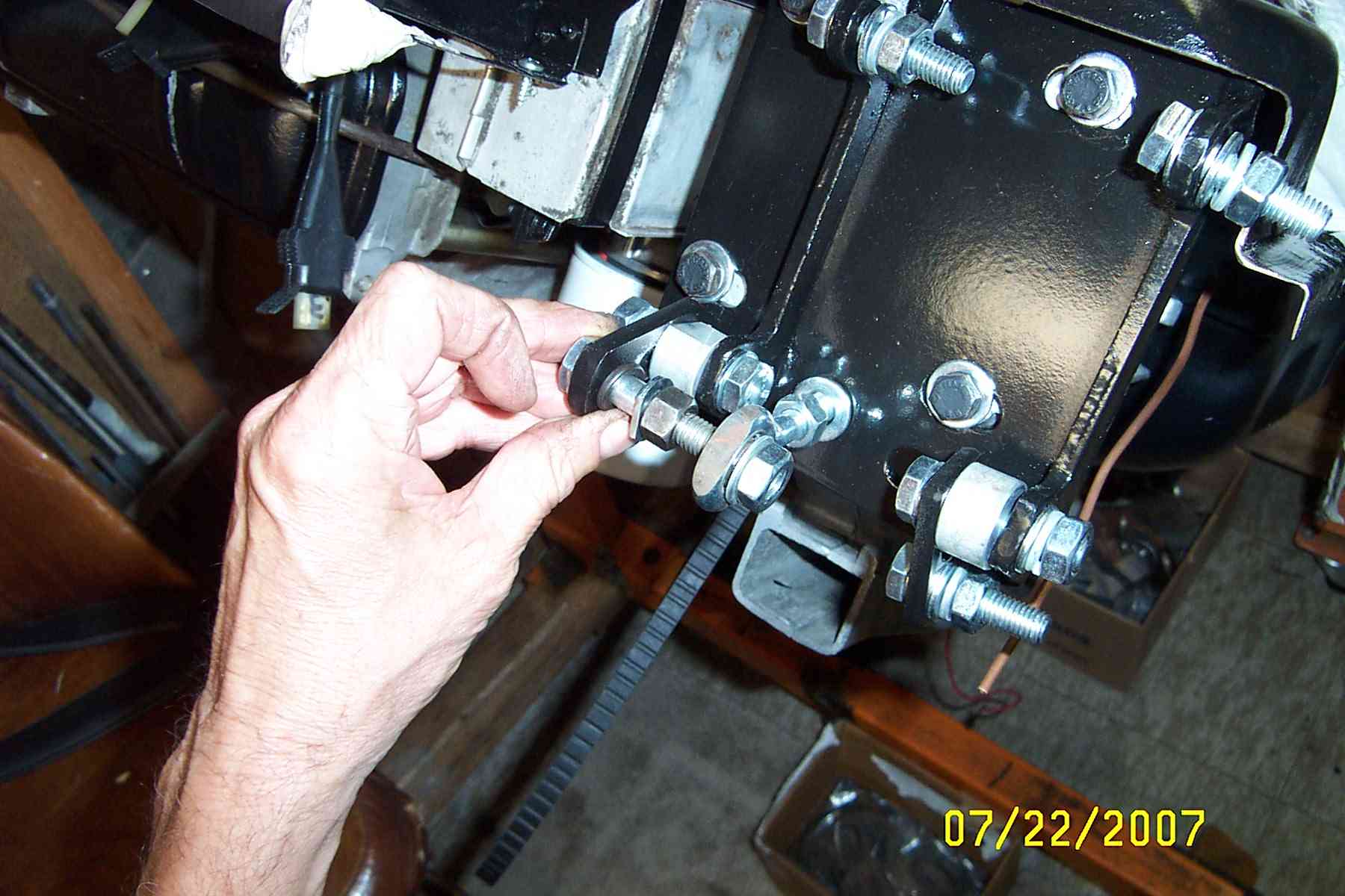

I too used a York to Sanded adapter on a DPD system which we converted to 134a. We modified the brackets to allow for an easier adjustment and less hardware. All new barrier hoses were used with the new compressor. The system works great with 40 deg. vent temperatures at higher RPM. Only problem is engine is a 1972 1.7L and not a lot of HP. Had to rig up an additional air valve to get more air on idle as car would die from the load.
Hope the picture help.
