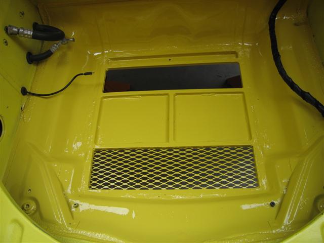

Seriously...here's a shot of body work up front where the condensor goes..This is the strongest and cleanest setup I've seen...not mine, but getting ready to do mine this way. (IMG:style_emoticons/default/smash.gif)
