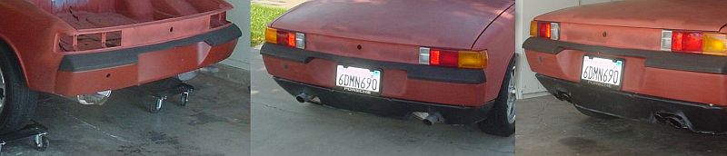

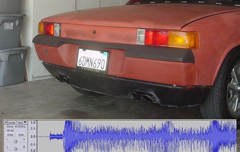

I took...no, "I drove the car" down to the muffler shop today and had quad exhaust added to the turbo mufflers to fill the valance exhaust holes of the valance that I picked up from Jamie Rust. It turned out really good.
Here's a picture before a valance (used a 71 deep valance), single outlet, then dual.
Just for fun...let's hear it roar to life! mp3
