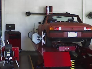

computers4kids
post Aug 1 2008, 06:38 PM
Love these little cars!
Posts: 2,443
Joined: 11-June 05
From: Port Townsend, WA
Member No.: 4,253
After the muffler shop, drove it down to this high tech alignment shop we have in town and they got the car all dialed-in. They also gave the front end a clean bill of health afterwards. The drive home was great...smooth and quite...no more clunk. At least I didn't hear it anymore?
