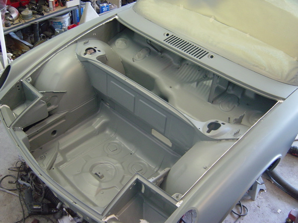

After a lot of work I finally primed the interior compartment today.
I stripped off the paint
Installed Engman's long stiffener kit,
Redid the speaker hole patch in the fire wall
Made a hand throttle
This is the speaker hole patch before and after

Ok I've been bad about updating my progress its been awhile but its coming along pretty good. So here is the front end primed with PPG DP 40.

sww914   When you're painting interiors, trunks, or eng...   May 25 2008, 01:19 PM
computers4kids   When you're painting interiors, trunks, or en...   May 25 2008, 01:38 PM
sww914   When you're painting interiors, trunks, or e...   May 26 2008, 12:06 AM
3d914   Very nice work Craig. What was your choice of prim...   May 25 2008, 02:52 PM
craig downs   Thanks Stephen I used PPG DP40 epoxy primer and ha...   May 25 2008, 11:38 PM
craig downs   Ok guys here is some more. On to the front where I...   May 26 2008, 12:02 AM
craig downs   I had to remove the head light box because when I ...   May 26 2008, 12:03 AM
craig downs   With the fenders install   May 26 2008, 12:11 AM
craig downs   I thought it would be a good idea to check and mak...   May 26 2008, 12:24 AM
craig downs   Hear it is done along with the drivers side.   May 26 2008, 12:27 AM
craig downs   Thanks Steve for the tip about using foil. I never...   May 26 2008, 12:30 AM
