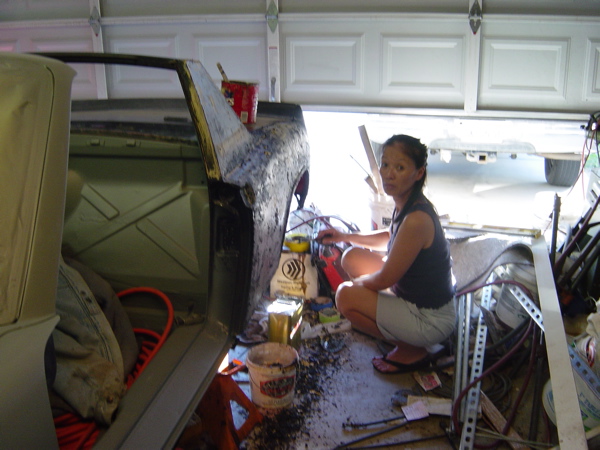

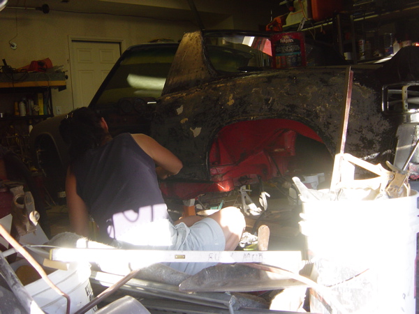

craig downs
post Aug 3 2008, 12:58 AM
Posts: 769
Joined: 25-November 05
From: mira loma ca.
Member No.: 5,189
My wife came out and said I'm board is there anything I can do.
So I said hmm do you want to strip some paint and she said ok.
