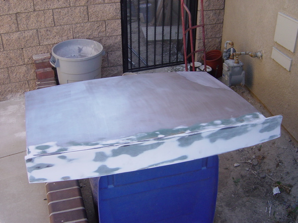

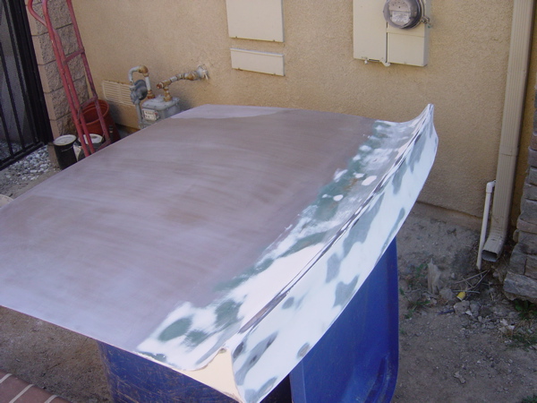

This is how I chose to do the spoiler. I cut off the ends and mounted them on the rear fenders. I mixed up some fiberglass resin and took some mat and shredded it and
mixed it in with the resin used it to blend it into the lid. You have to make sure you get all the air pockets out of the resin or you could have trouble later on. Then I used body filler with fiberglass strands to finish it.
