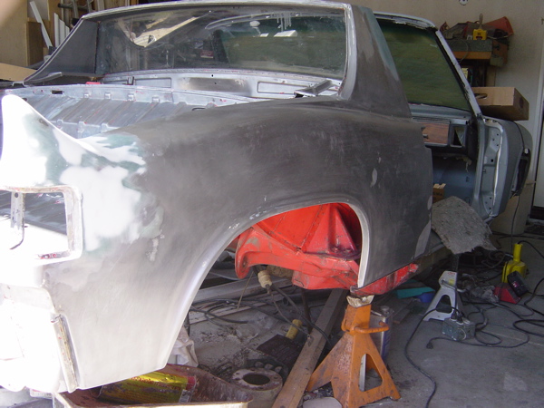

After a lot of work I finally primed the interior compartment today.
I stripped off the paint
Installed Engman's long stiffener kit,
Redid the speaker hole patch in the fire wall
Made a hand throttle
This is the speaker hole patch before and after

craig downs   So you dug up my thread. Ok I'll post some mor...   Apr 28 2008, 01:24 AM

craig downs   Thanks Stephen I used PPG DP40 epoxy primer and ha...   May 25 2008, 11:38 PM
craig downs   Ok guys here is some more. On to the front where I...   May 26 2008, 12:02 AM
craig downs   I had to remove the head light box because when I ...   May 26 2008, 12:03 AM
craig downs   With the fenders install   May 26 2008, 12:11 AM
craig downs   I thought it would be a good idea to check and mak...   May 26 2008, 12:24 AM
craig downs   Hear it is done along with the drivers side.   May 26 2008, 12:27 AM
craig downs   Thanks Steve for the tip about using foil. I never...   May 26 2008, 12:30 AM

craig downs   Ok I've been bad about updating my progress it...   Aug 3 2008, 12:43 AM
craig downs   My wife came out and said I'm board is there a...   Aug 3 2008, 12:58 AM
craig downs   I was painting a wine rack for work and when I clo...   Aug 3 2008, 01:04 AM
craig downs   This is how I chose to do the spoiler. I cut off t...   Aug 3 2008, 01:16 AM
craig downs   Here is how the ends look like.   Aug 3 2008, 01:19 AM

craig downs   Rear end ready for 1st coat of primer   Sep 4 2008, 12:59 AM
craig downs   Rear end primed with epoxy primed   Sep 4 2008, 01:02 AM
craig downs   Next I sprayed some primer surfacer and a guide co...   Sep 4 2008, 01:06 AM
craig downs   I put the suspension back on the car so I can push...   Sep 4 2008, 01:13 AM
