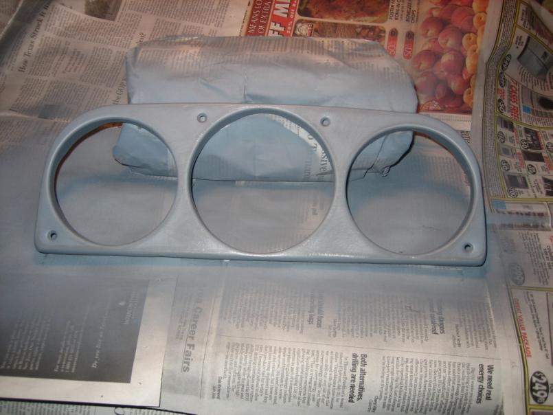

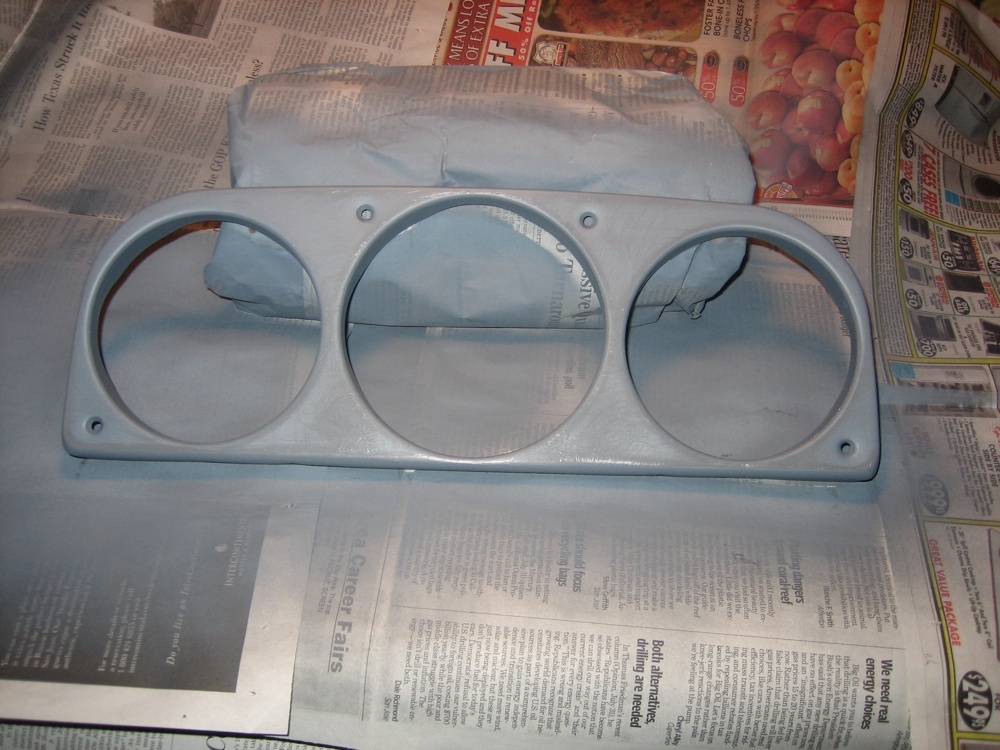

malaga_red75
post Aug 8 2008, 11:52 PM
'74 2.5L N/A Subie
Posts: 454
Joined: 5-March 06
From: Menlo Park, CA
Member No.: 5,674
primed, painted, baking
