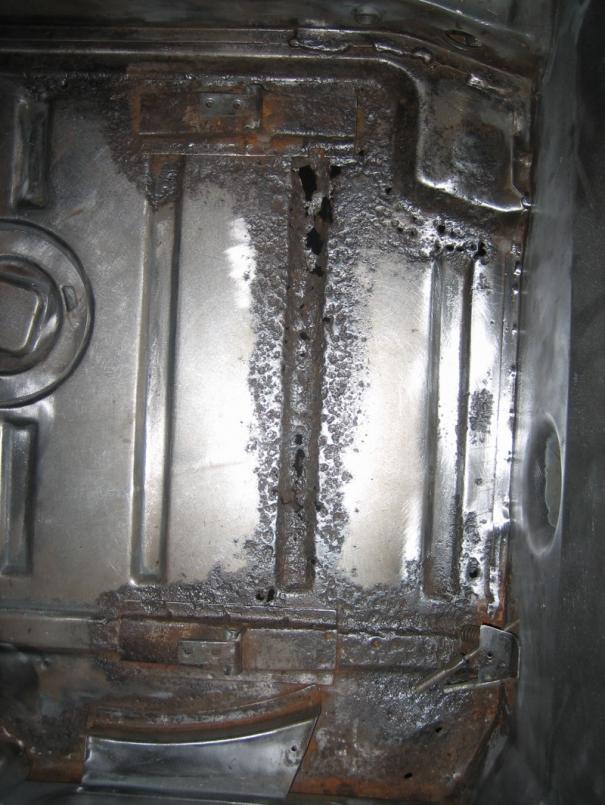

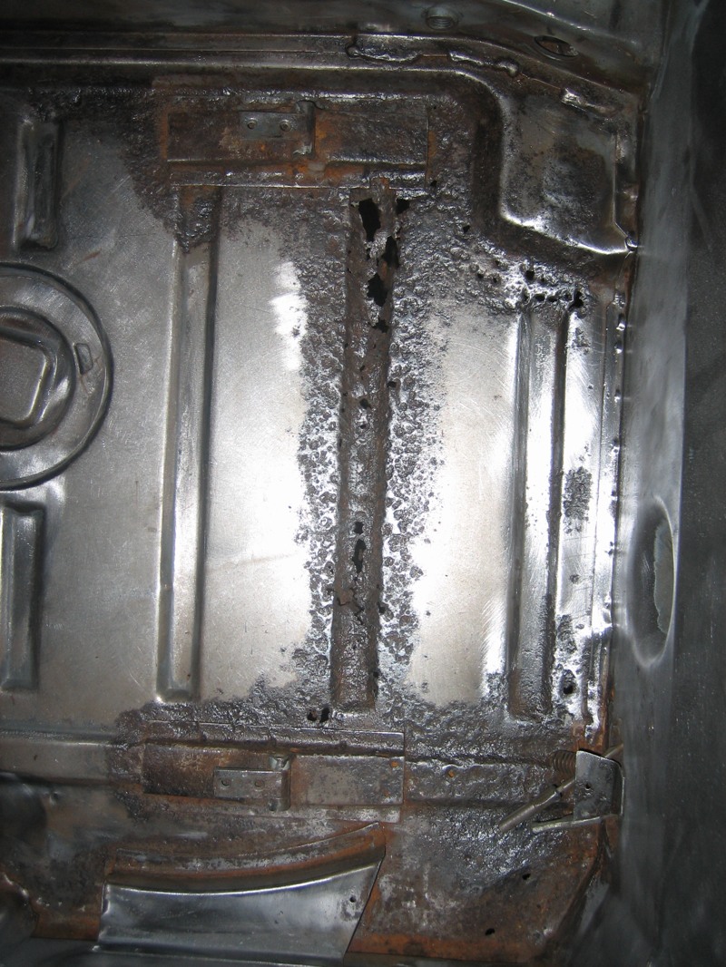

post Aug 8 2008, 11:58 PM
'74 2.5L N/A Subie
Posts: 454
Joined: 5-March 06
From: Menlo Park, CA
Member No.: 5,674
rust....

malaga_red75   Alright, So here is what I have been up too. I s...   Aug 8 2008, 11:49 PM
malaga_red75   down to metal   Aug 8 2008, 11:50 PM
malaga_red75   ...   Aug 8 2008, 11:51 PM
malaga_red75   primed, painted, baking   Aug 8 2008, 11:52 PM
malaga_red75   ...   Aug 8 2008, 11:53 PM
malaga_red75   ...   Aug 8 2008, 11:54 PM
malaga_red75   DONE!!!!   Aug 8 2008, 11:54 PM
malaga_red75   Metal...lots o metal......and some rust :angry:   Aug 8 2008, 11:56 PM
malaga_red75   ...   Aug 8 2008, 11:57 PM
malaga_red75   rust....   Aug 8 2008, 11:58 PM
malaga_red75   The tools I am using... Various sizes of wire bru...   Aug 9 2008, 12:01 AM
