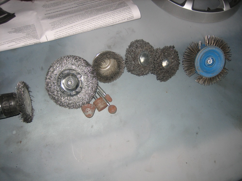

The tools I am using...
Various sizes of wire brush (crimped) wheels
2 paint/rust remover wheels
that big one is called a removal all brush or something like that...worked really well to get the first layer of bulky rust off
small grinding wheels, a couple different styles, VERY useful for getting the tiny joints and areas where the wheels couldnt get too.
