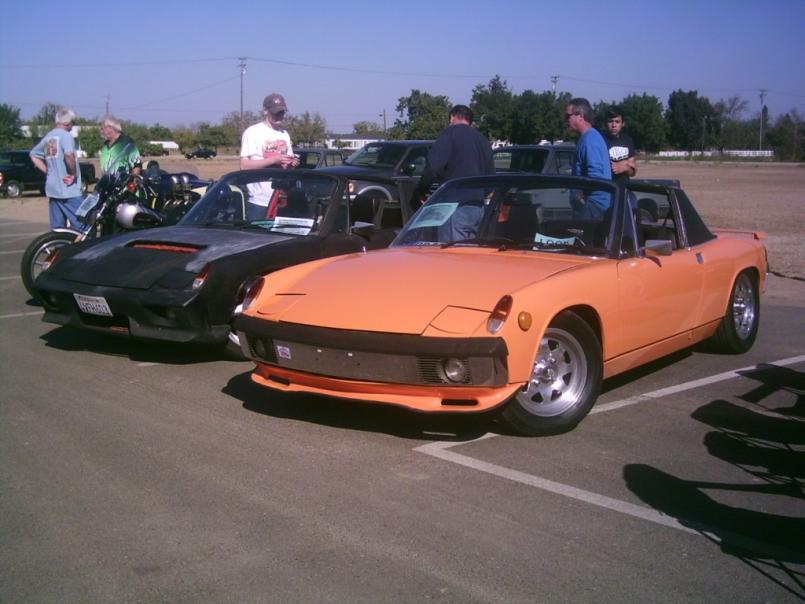

i'm running 205 x 15 kumo ecsta on 5.5 rim. a bit chubby for the rim but NEVER interfers, front or rear. i've mock uped a set of 17x7's and with spacers in front would fit real nice
