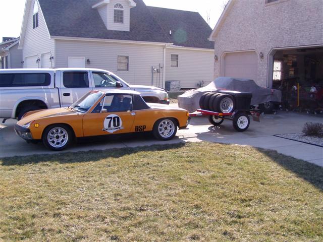

I run the 6.5 x 15 minilites with 205 on them. My rear fender lips are rolled, but even if the weren't they still would fit.
