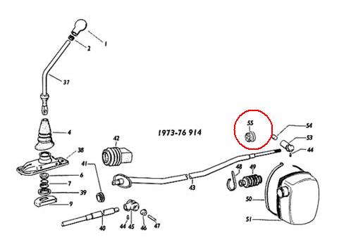

I think your bronze bushing is binding. You can't get clean shifting full left and right of the pattern at the same time because the bushing is limiting the off-axis rotation of the shift rod. The factory plastic bushing is hourglass shaped to prevent binding.

QUOTE(James Adams @ Jul 29 2008, 07:05 PM) *
Were talking about the console bushing correct? #55?

QUOTE(jasons @ Jul 29 2008, 10:36 PM) *
where do i get a bronze bushing, and what is the part number?
