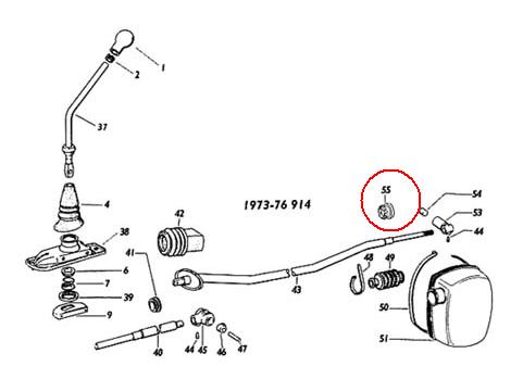

I think your bronze bushing is binding. You can't get clean shifting full left and right of the pattern at the same time because the bushing is limiting the off-axis rotation of the shift rod. The factory plastic bushing is hourglass shaped to prevent binding.

QUOTE(James Adams @ Jul 29 2008, 07:05 PM)
Were talking about the console bushing correct? #55?
JWest
Jul 29 2008, 08:48 PM
QUOTE(jasons @ Jul 29 2008, 09:36 PM)
Yes, but a bronze bushing at the firewall can have the same effect.

Click to view attachmentwhere do i get a bronze bushing, and what is the part number?

The bronze bushing at the fire wall is an after market part and is meant to replace #41. James sells these.
