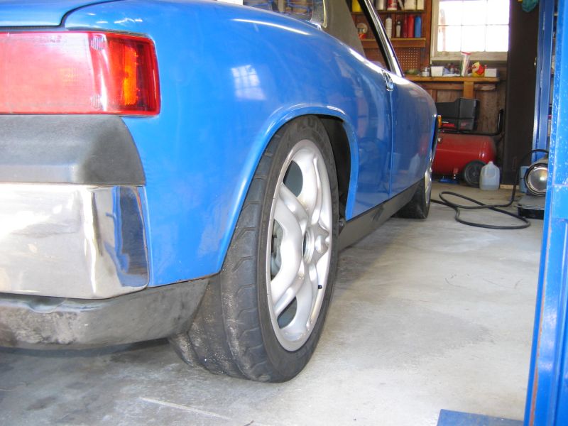

Also, my former setup, 205/45/16 Kumho Ecsta V700
on 7x16 40mm offset boxster wheel.

mskala   The best offset for the rear is about 36mm, which ...   Aug 9 2008, 07:18 PM

mskala   If you have decent negative camber, you may be abl...   Aug 11 2008, 09:26 PM
mskala   pic #2   Aug 11 2008, 09:26 PM
mskala   Also, my former setup, 205/45/16 Kumho Ecsta V700 ...   Aug 11 2008, 09:29 PM
