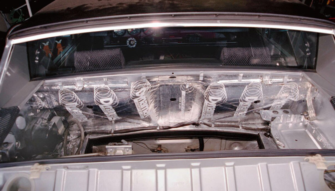

Zach,
Here is a picture of the firewall (engine side) that I did in Dynamat super, I had good results with it. Of course it does not look original any longer.
Dominic
