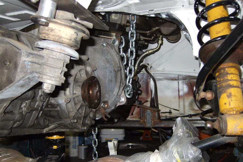

I found a 73 914 in good condition in July 2006. The intention from day one was to convert this car to electric or diesel.
The car had been stored for 19 years. I had to do the typical flush the gas tank rebuild the calipers etc. I put a hundred miles or so on the motor that was in the car and then it sat for a few months while I started gathering up information to do an EV
conversion. The numbers for weight and range just didn't add up for my requirements so a diesel conversion was decided on. Now I just hope to get it running before we run out of oil.

Some pics of the slow progress

Bill D   I have the engine in place with a fabricated front...   Aug 13 2008, 01:28 PM
Bill D   Some pics of the slow progress   Aug 13 2008, 04:52 PM
