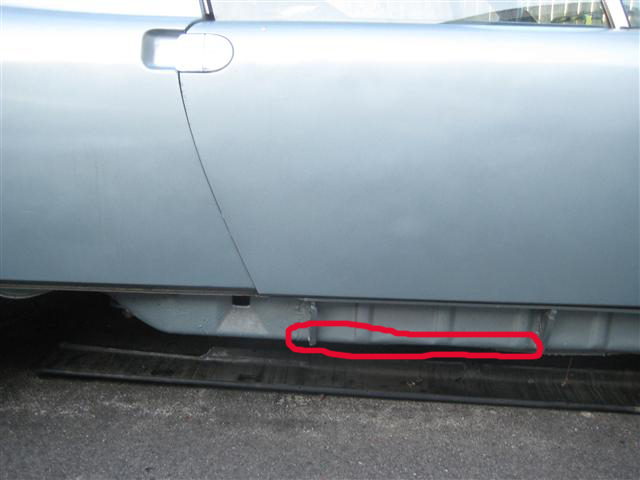

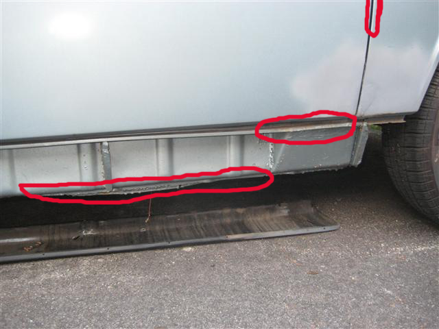

My passenger door is sagging and I need an inexpensive way to fix it. My goal is not to have a show car but a decent driver ( without a sagging frame). I do not think it is too bad yet but the passenger door is deffinently off. I placed a jack under the front and when I raised the car the door aligned prety good. I have attached a couple of pics if it helps. It looks like the P.O did some work because the the outter portion of the long looks fairly good. Also I removed the carpet to see if that revealed anything and it looks pretty good. I can not see anything from inside the car but under there is some rust. It does not look as bad as some that I have seen but I am not an expert by any means. Any suggestions on what I could do to get by.

QUOTE(JOE M @ Aug 19 2008, 05:34 PM) *
Visual clues concern me.
What I cannot see in the photos concerns me even more!

r_towle   Where are you located in NH??? I am just south of ...   Aug 19 2008, 07:29 PM

r_towle   some one anyone please help. Do I need to remove ...   Aug 19 2008, 07:35 PM
Todd Enlund   Your longs dont look bad from the pics, but they ...   Aug 19 2008, 07:46 PM
r_towle   Your longs dont look bad from the pics, but they...   Aug 19 2008, 07:55 PM

SirAndy   Show us a pic of the hell hole and the floor pan f...   Aug 19 2008, 07:31 PM

r_towle   Joe only lives about ten minutes from my shop... I...   Aug 20 2008, 08:13 AM

sww914   We also need to see the area directly above the ar...   Aug 20 2008, 06:40 PM
r_towle   bottom of long has been patched and welded Inner l...   Aug 20 2008, 07:19 PM
Vacca Rabite   bottom of long has been patched and welded Inner ...   Aug 20 2008, 07:27 PM
r_towle   when I get there I will take a look. I think we ca...   Aug 20 2008, 08:02 PM

r_towle   Joe's car is fine. Looks like alot of welding ...   Aug 22 2008, 06:10 PM
