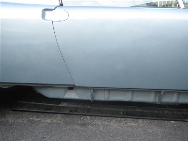

My passenger door is sagging and I need an inexpensive way to fix it. My goal is not to have a show car but a decent driver ( without a sagging frame). I do not think it is too bad yet but the passenger door is deffinently off. I placed a jack under the front and when I raised the car the door aligned prety good. I have attached a couple of pics if it helps. It looks like the P.O did some work because the the outter portion of the long looks fairly good. Also I removed the carpet to see if that revealed anything and it looks pretty good. I can not see anything from inside the car but under there is some rust. It does not look as bad as some that I have seen but I am not an expert by any means. Any suggestions on what I could do to get by.

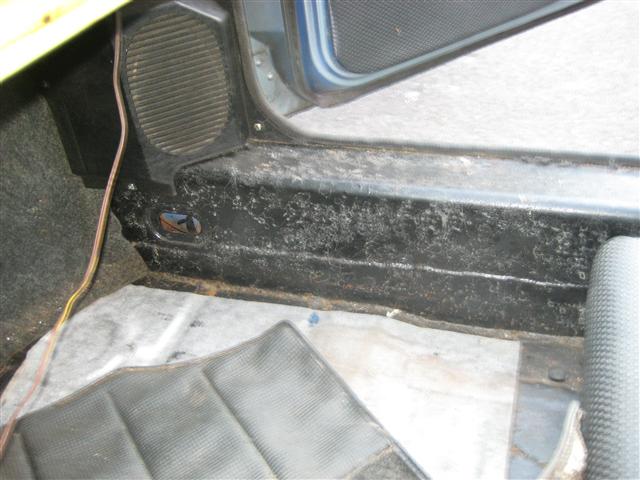

some one anyone please help. Do I need to remove anything else to reveal what the extent of the damage is. Is there any cheats to fixing this type of damage because as I said all I want is a decent driver not a show car. I do not think it sagging too much but it is obvious there is a problem. How safe is it to drive as is.
Show us a pic of the hell hole and the floor pan from underneath on that side. also, a shot of the area inside the pass. side rear fender well. Jack the car up and take the rear wheel off to get some good shots.

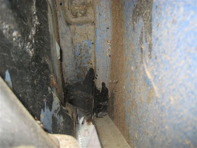

The "hell hole" is the part of the "frame" just below the battery tray.
Move the computer and take a few pics from the engine bay into that area.
Take a few pictures below that area from under the car and show the bottom of the long.
Your longs dont look bad from the pics, but they do look repainted.
It may have been repaired yet not welded properly.
The door could be misaligned.
Has this car had a front end accident? If so it could change the front door gap and to get that right the door was adjusted poorly.
I can make the door look alot better just by adjusting and a few special tricks.

I don't suppose it is something as simple as the door being out of alignment?

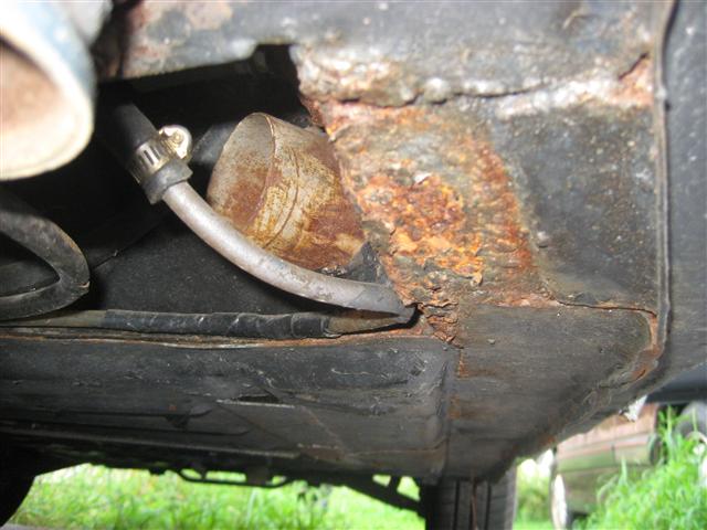

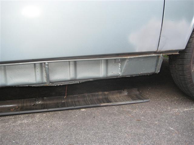

Thanks for you optimistic outlook Zach. Here are a few more pics. inside of the car,under the rear wheel well and along the bottom. Hope these reveal something.
sww914
We also need to see the area directly above the area in your last pic. That's the bottom of the long, it would be nice to see the area below and in front of where the battery is/was, the RF lower corner of the engine compartment.
r_towle
bottom of long has been patched and welded
Inner long has been welded to floor
hello hole bottom has been welded...
Overall I think you are fine, just a bit of tweeking and ALOT of elbow grease to clean the current rust and undercoat it...

So whats with the door gap? Did the tub twist when it was welded, or is the door just out of alignment?

Joe's car is fine.
Looks like alot of welding was done on the passenger side...fairly decent job. The jack post was never put on...but a new outer long was...
Looks like the long may have shrunk a bit due to welding and the door was never adjusted properly...
I showed him how to adjust it and went through a bit of talk on his carbs...

I jumped up and down on the long...its solid...He was watching.
The long is fine, but is was shrunk when welded up..
this is a common issue when a shop welds up the long...they are in a hurry to get it done and with no bracing and to much heat, this happens.
the cure will be to raise the door up a bit more than stock which requires ovaling out the fender where the hinged mount...
It can be done and its really not to hard.
when you raise the door the lower rear gap gets larger due to the shape of the door.
Currently his door is mounted lower than stock.
The top edge and the upper part of the fender are higher than the door.
Raise it up as far as you can get it...remove the door and grind out a bit of metal to move the hinges up higher..get another 1/8 inch and you will be very happy.
