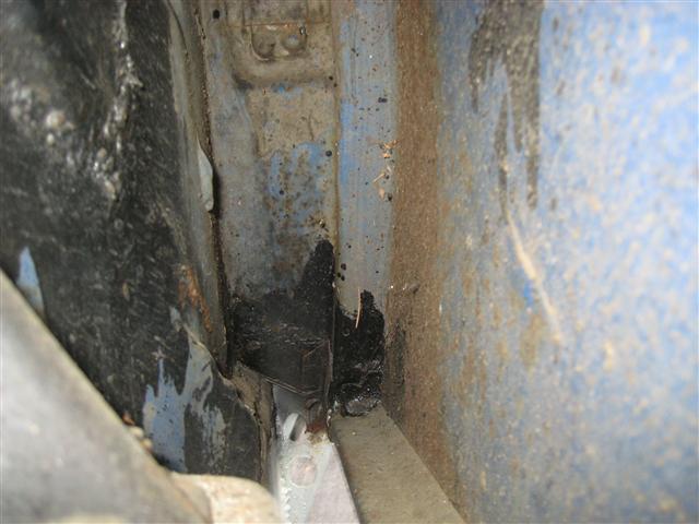

My passenger door is sagging and I need an inexpensive way to fix it. My goal is not to have a show car but a decent driver ( without a sagging frame). I do not think it is too bad yet but the passenger door is deffinently off. I placed a jack under the front and when I raised the car the door aligned prety good. I have attached a couple of pics if it helps. It looks like the P.O did some work because the the outter portion of the long looks fairly good. Also I removed the carpet to see if that revealed anything and it looks pretty good. I can not see anything from inside the car but under there is some rust. It does not look as bad as some that I have seen but I am not an expert by any means. Any suggestions on what I could do to get by.

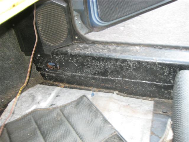

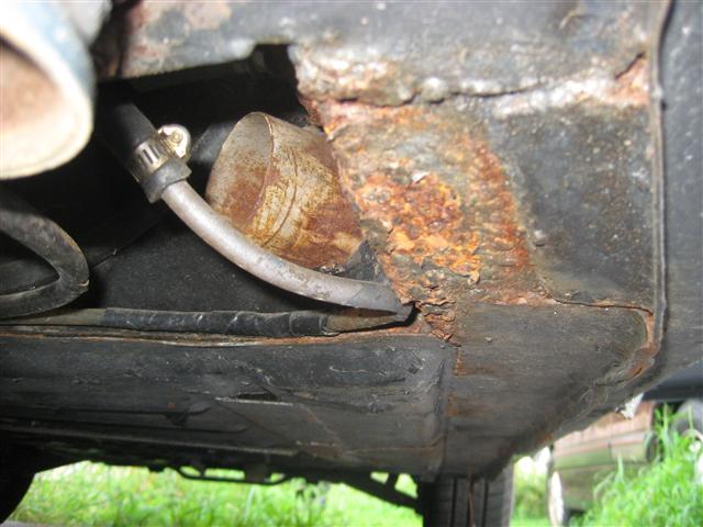

Thanks for you optimistic outlook Zach. Here are a few more pics. inside of the car,under the rear wheel well and along the bottom. Hope these reveal something.
