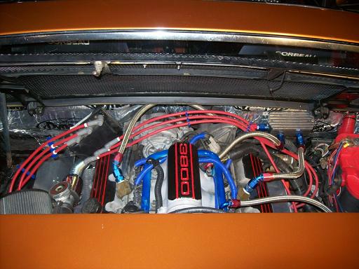

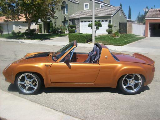

Attached ImageGood points made here. Not to keep things going , but just to throw in my point of view, I think Sawtooth should consider the point of selling the car and getting one that does not have as good mileage (cheaper), but the body is good, or frame 914 , and consider a couple of other things, as well. I have done a conversion on my car, and really enjoy it. It is definately worth NOT being a "contour" car, and all this value stuff.......well, maybe in another 30 years, because the only car collector enthusiasts that I have EVER heard about trying to find these 914s is ......us, 914 guys.( I wonder if Jay Leno has a 914 in his car collection....) But his (Sawtooth) car is immaculate stock from the start. Do you plan on modifying the body ? How about the interior ? Suspension, for sure, like said up above. If you are going to do these things, If it were me, after the experience I have had, (a good one) I would sell, the stock car, make a profit, (you already have a nice offer to put you ahead without having to wait for a buyer) and find a nice custom framed car, plan your COMPLETED project, and build off of the frame. You see, if you are going to change everything anyway, there simply is no need to keep this car, when you can make money off of it, buy one that is already stripped, and ready for modifications, for less money, or already done custom caged and all, and you will spend the same money anyways, but swapped a stock car for a custom chassis, without having to go throught the headache of having to sale all your individual pieces and parts !!! You might even want a tinted windshield. My point is , consider the overall project , not just the engine swap, to see if keeping this car is going to really benefit you in the long run, or are you really going to lose out on making some nice cash, finding another car you can take advantage of because you are doing a conversion, and be done with it. If you do a conversion, You are going to be adding torque to this car, that will twist the frame, you will need to add strength to the car, (IMG:style_emoticons/default/welder.gif) as well as time and money. Why not get a car that already is pretty much where you want to be, just needing your engine, and your custom touch, this will save lots of time and headaches ( with that being said, this is why I brought my conversion already done in another 914, and just swapped everything over to my 914, trust me , this made life so much easier !!!)....... This is just what I would do. Wish you the best. (IMG:style_emoticons/default/smile.gif)
