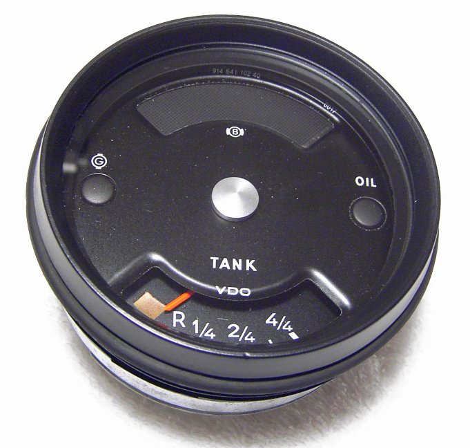

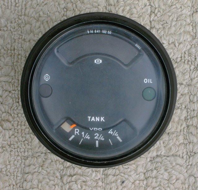

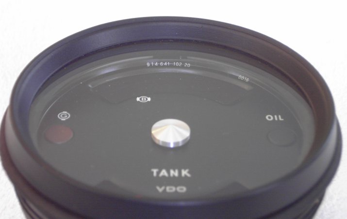

LOOKING AT THE SITE YOU LINKED TO, IT SEEMS THIS IS EASY. THE PART NUMBER IS ON THE FACE OF EACH GUAGE, TOP CENTER. THERE ARE -10, -20, -40 AN -50 GUAGES AVAILABLE. JUST LOOK AT THAT AND VIOLA!
FUEL GUAGE LINK
