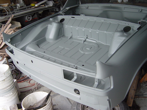

After a lot of work I finally primed the interior compartment today.
I stripped off the paint
Installed Engman's long stiffener kit,
Redid the speaker hole patch in the fire wall
Made a hand throttle
This is the speaker hole patch before and after

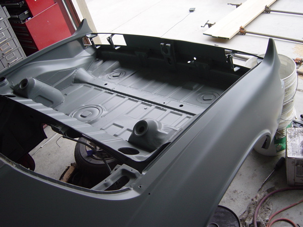

post Sep 4 2008, 01:02 AM
Posts: 769
Joined: 25-November 05
From: mira loma ca.
Member No.: 5,189
Rear end primed with epoxy primed

craig downs   So you dug up my thread. Ok I'll post some mor...   Apr 28 2008, 01:24 AM
thesey914   nice repair Criag - I'm so glad that you repla...   Apr 28 2008, 04:20 AM

3d914   Very nice work Craig. What was your choice of prim...   May 25 2008, 02:52 PM
craig downs   Thanks Stephen I used PPG DP40 epoxy primer and ha...   May 25 2008, 11:38 PM

craig downs   Rear end ready for 1st coat of primer   Sep 4 2008, 12:59 AM
craig downs   Rear end primed with epoxy primed   Sep 4 2008, 01:02 AM
craig downs   Next I sprayed some primer surfacer and a guide co...   Sep 4 2008, 01:06 AM
craig downs   I put the suspension back on the car so I can push...   Sep 4 2008, 01:13 AM
