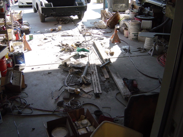

I put the suspension back on the car so I can push it in and out of the garage while wet sanding and painting. After over a year on jack stands here is the mess that was created.
Boy what a mess.
