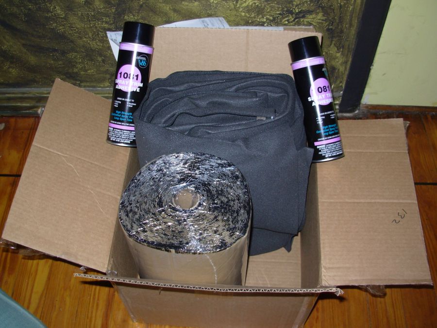

Here is a picture of what I ordered. I start as soon as I get my coffee fix.
T.C.

carr914   Here is a picture of what I ordered. I start as so...   Sep 11 2008, 08:23 AM
carr914   First, you only need a few tools; a utility knife,...   Sep 11 2008, 02:35 PM
carr914   Next if your going to add another layer of RaaMmat...   Sep 11 2008, 02:42 PM
