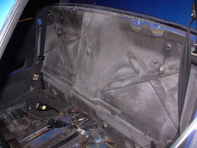

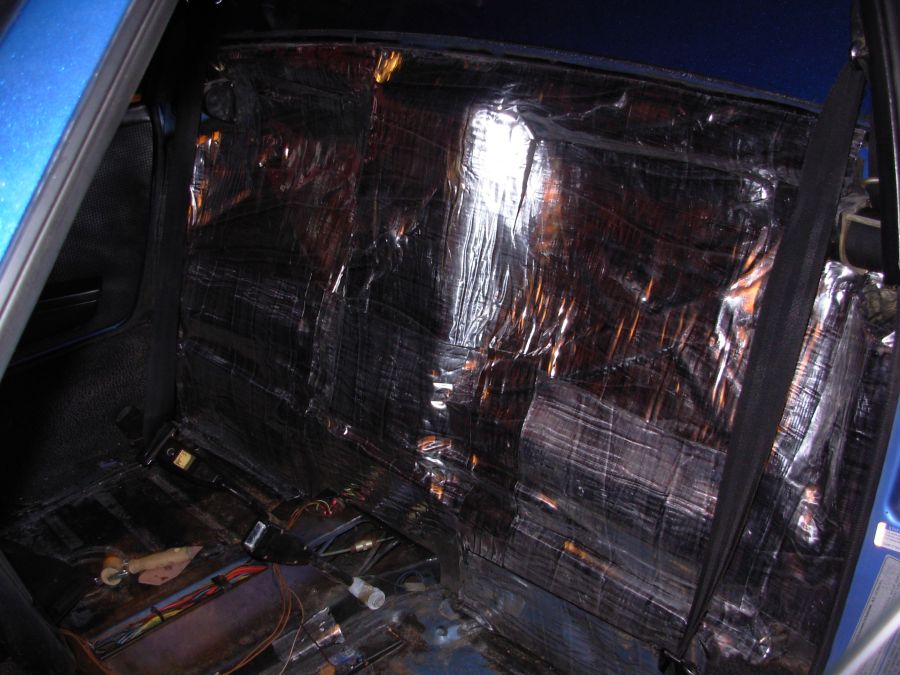

First, you only need a few tools; a utility knife, a small sqeezge, and I used a wallpaper roller. You need gloves, as this stuff will stick. I put a pair of latex gloves on then a set of leather gardening gloves over them. If you just use latex, the adhesive will rip them off your hands.
Second, take out your interior.
Third, make sure your surface is clean. I KaBOOM'd it. Then I started laying the RaaMMat. Pretty easy. You get used to how long of pieces to use. I laid down the mat, pressed it down with my hands, then used my sqeezge, then the wallpaper roller.

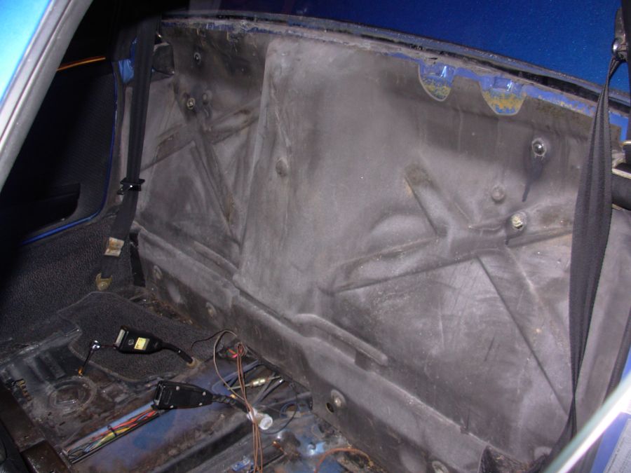

Dominic   Zach, Here is a picture of the firewall (engine si...   Aug 12 2008, 08:21 PM

carr914   Here is a picture of what I ordered. I start as so...   Sep 11 2008, 08:23 AM

carr914   Ensolite is now trimmed then I put a layer of Perl...   Sep 13 2008, 05:37 PM
carr914   The interior back in. I also put on headers and Me...   Sep 13 2008, 05:39 PM
