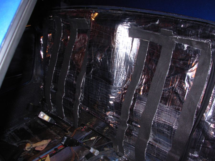

Next if your going to add another layer of RaaMmat (heck they give you alot of the stuff) (I am as the engine is right behind me and I'm going to be running headers into Mega-Phones (IMG:style_emoticons/default/biggrin.gif) and I still want to hear the stereo.) you cut strips of the Ensolite and glue them to your 1st layer of Mat. The MAT will stick to itself, but does not like to stick to the Ensolite, that's why you use strips.
Then put your second layer of RaaMmat.

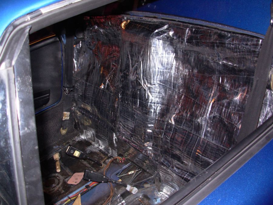

carr914   I got my RaaMmat today, so will be starting to ins...   Sep 10 2008, 06:51 PM
carr914   Another thing about RaaMmat or the owner. Great cu...   Sep 10 2008, 09:29 PM
carr914   Here is a picture of what I ordered. I start as so...   Sep 11 2008, 08:23 AM
carr914   First, you only need a few tools; a utility knife,...   Sep 11 2008, 02:35 PM
carr914   Next if your going to add another layer of RaaMmat...   Sep 11 2008, 02:42 PM

carr914   Ensolite is now trimmed then I put a layer of Perl...   Sep 13 2008, 05:37 PM
carr914   The interior back in. I also put on headers and Me...   Sep 13 2008, 05:39 PM

carr914   With the center section of the backpad installed. ...   Sep 14 2008, 11:05 AM
