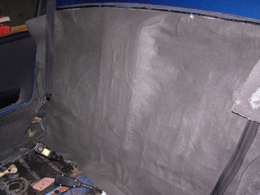

QUOTE(turnaround89 @ Sep 12 2008, 10:21 AM) *
I don't really understand what the Ensolite is used for. Wouldn't you want the RaaMmat to stick more to itself instead of creating a pocket where it won't stick? could you explain why you used the ensolite because i want to put some edead in my car and just want to know if the ensolite helps kill more sound? thanks
I didn't get a pocket where it didn't stick. Rick explained to me that if I were to put a full sheet of Ensolite in the sandwich there could pockets. I sprayed adhesive over the strips and then put another layer of RaaMmat.
The way I see it, the RaaMmat keeps sounds from coming into the cabin and the Ensolite stops reverberation inside. If you look at a professional recording studio, the walls will be constructed with a ton of insulation and then will have foam walls.
Here is my Ensolite final layer. I'm letting the adhesive dry before I trim it.
