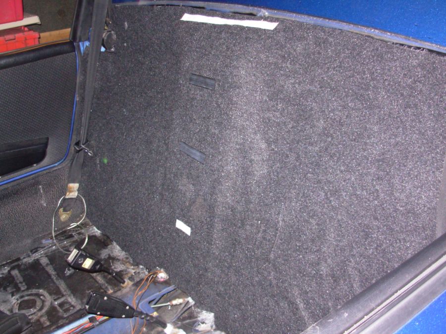

Ensolite is now trimmed then I put a layer of Perlon to look like a GT. The Velcro will be used to hold the the center section of the backpad.
