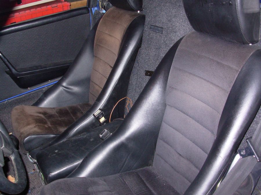

carr914   Ensolite is now trimmed then I put a layer of Perl...   Sep 13 2008, 05:37 PM
carr914   The interior back in. I also put on headers and Me...   Sep 13 2008, 05:39 PM
