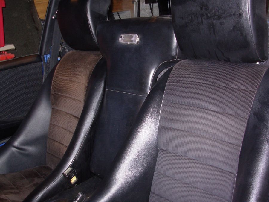

With the center section of the backpad installed.
I'll be doing the doors soon.
