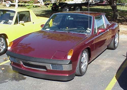

Okay so I did a search & looked at quite a few different topics. I saw some examples but they are spread between quite a few posts. So I was hoping I could get you v8 guys to put up some pics here.
Considering the bumper cutout to match the foglight grills & then Renegades valance. Not sold on that setup though. I'd kind of like to cutout the bottom of the bumper & tie whatever valance into the cut. While having a ram in the valance that matches the bumper width wise.
So please show me what you got (IMG:style_emoticons/default/aktion035.gif) Bumper radiator wise that is (IMG:style_emoticons/default/dry.gif)

This is pretty..... remember intake size is less important than exit area.

Rand   My favorite is one of our PNW guys, "jmmotors...   Sep 21 2008, 10:27 PM
JRust   I have admired Jim's car for a long time. I do...   Sep 21 2008, 11:23 PM

JRust   Okay I finished my bumper. Didn't get my valan...   Oct 12 2008, 01:30 PM
computers4kids   Looks good Jamie...it does look familar though. :i...   Oct 12 2008, 04:13 PM
JRust   Looks good Jamie...it does look familar though. :...   Oct 13 2008, 01:36 AM
roadster fan   It looks great Jamie! I like the way it just ...   Oct 13 2008, 08:44 PM
