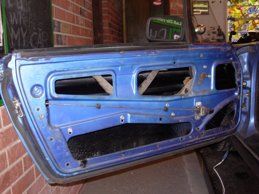

carr914   Now for the doors. Remove your door panels T.C. ...   Sep 23 2008, 12:15 PM
carr914   Now cut some strips of the RaaMat. You will get us...   Sep 23 2008, 12:21 PM

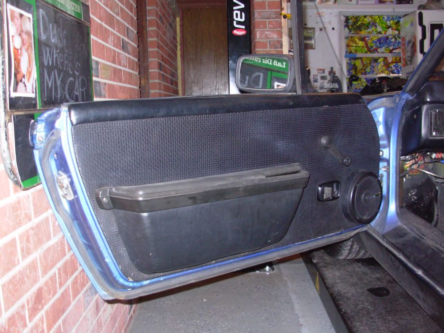

carr914   Clean up your door panel (it's easier to do wh...   Sep 23 2008, 12:24 PM
carr914   Here is the passenger door panel put back on. A...   Sep 23 2008, 02:09 PM
