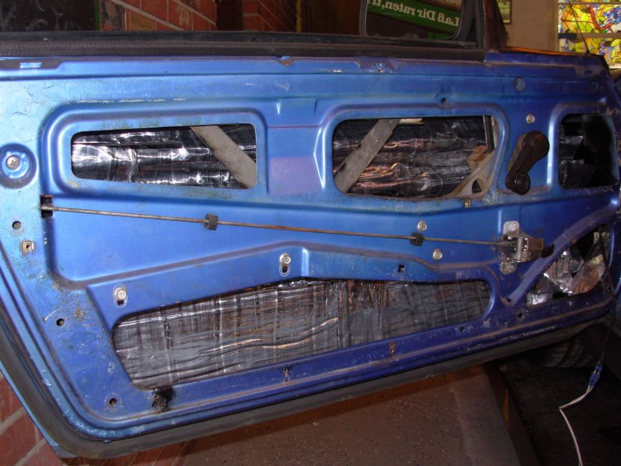

Now cut some strips of the RaaMat. You will get used to how big of strips you can use.
REMEMBER, put your gloves on - this stuff is stickier than elephant snot
Put the strips in and overlap as you go
Then I put a few strips on the inner panel. You have to be careful not to put the RaaMat over the door release rods.

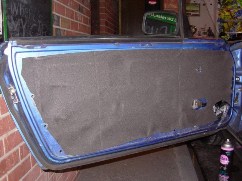

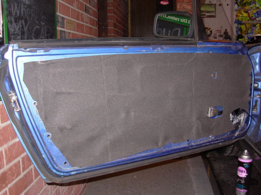

Then I cut a piece of Ensolite and glued in place
