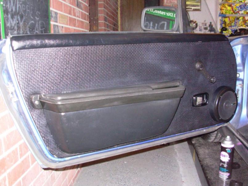

Clean up your door panel (it's easier to do while off) and reinstall
You will notice the weight you added to the door
And it will now close with a thud instead of a ping
Repeat with the passenger door. Each door took me less than a 1/2 hour
T.C.
