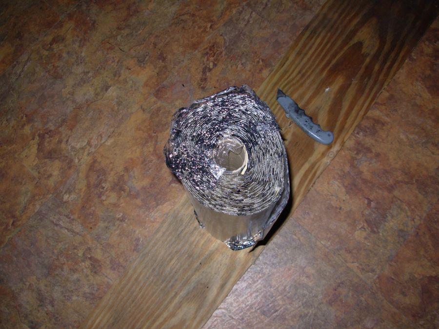

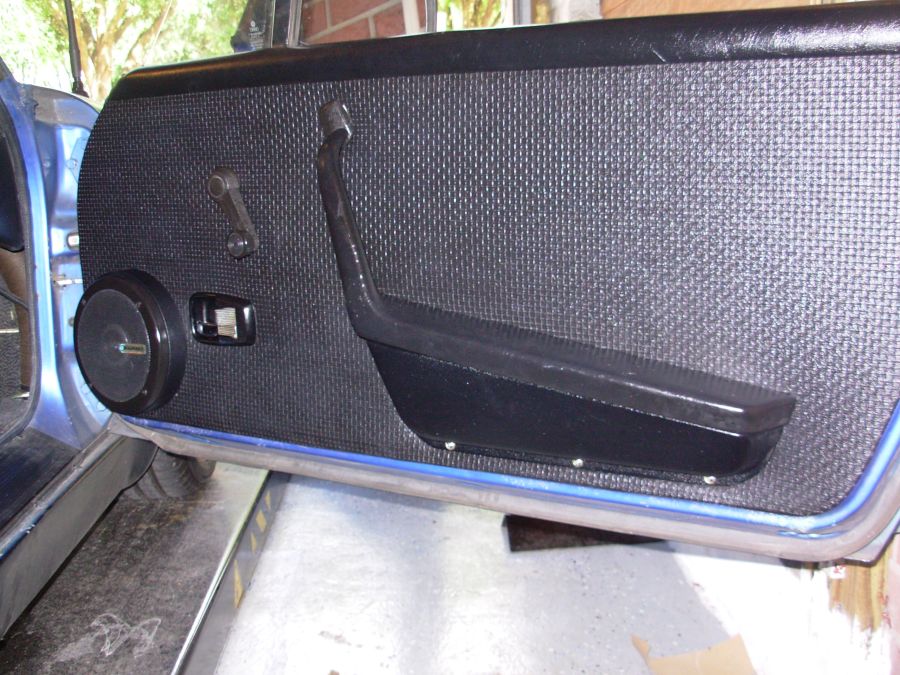

Here is the passenger door panel put back on.
And how much RaaMat I have left. I would bet I have enough to do another 914 if I don't double-up the back wall.
T.C.Attached Image

QUOTE(carr914 @ Sep 23 2008, 03:09 PM) *
T.C.Attached Image
Did you do your floors as well?
That is about how much RaaMat I have left now, and I did not do my doors, but I did do my floors.
Zach
