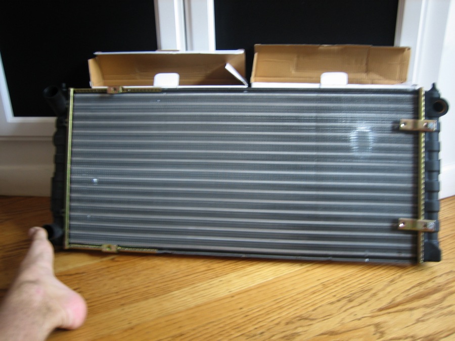

--radiator--

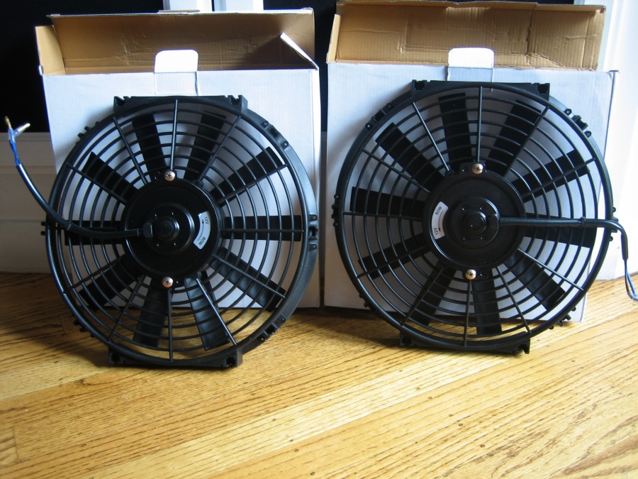

--fans--

TonyAKAVW   Excellent choice on the raditor :) And those fans...   Oct 10 2008, 04:58 PM
malaga_red75   Excellent choice on the raditor :) And those fan...   Oct 10 2008, 05:56 PM
