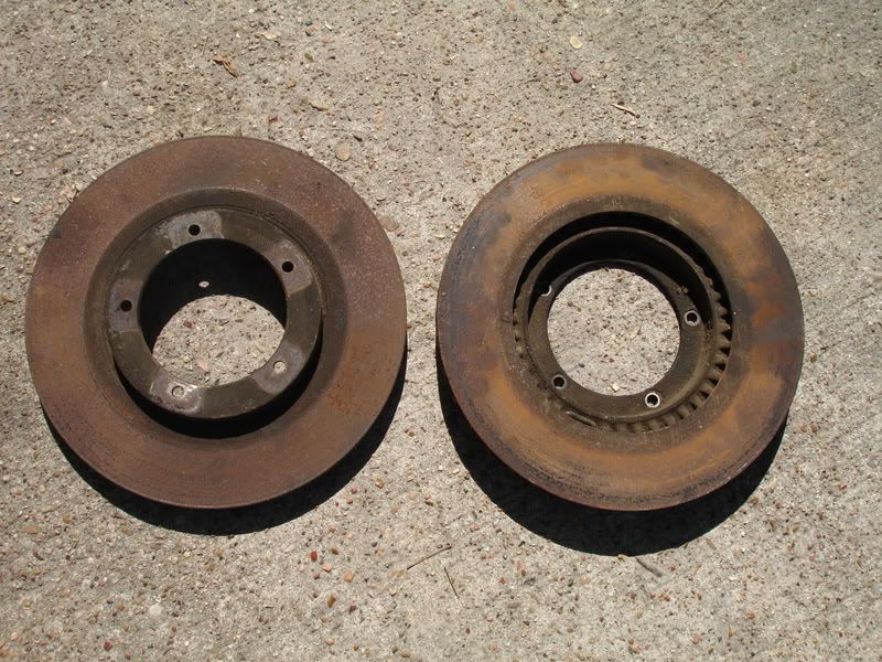

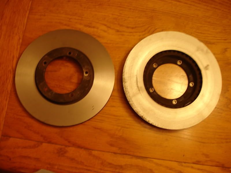

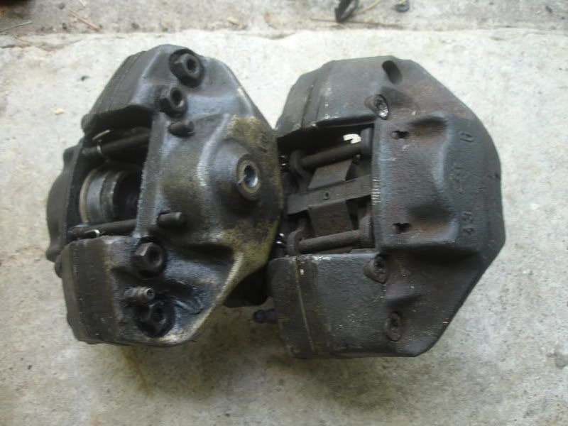

I am starting on the front end (steering, suspension, brakes) and I have come to a wall. Is there anyone in the Houston area (or willing to lend...I am honest) that will let me borrow a pin tool (4 grooved/pronged) for the lower strut?
Are there any other special tools that I will actually need when I rebuild the engine etc.? For instance, the front hub "required" a special tool resembling a mini crowbar, but a medium flathead and prying did the job just fine. Is this grooved socket worth the $65 to buy, and what are your thoughts on replacing it with a regular hex nut of the same thread and suspension washer for ease of removal for the future?
I have also done quite a bit of researching, and have acquired the original shop manuals for this unique beauty.
Any questions or pointers, I'd love to hear them! (IMG:style_emoticons/default/popcorn[1].gif)

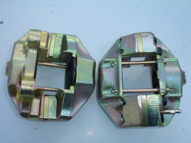

Anyways, on with the long overdue pictures (obviously only half the front setup is shown)...
(IMG:http://img.photobucket.com/albums/v124/big_pete139/1970%20Porsche%20914%206/DSC01158.jpg)
(IMG:http://img.photobucket.com/albums/v124/big_pete139/1970%20Porsche%20914%206/DSC00063.jpg)
(IMG:http://img.photobucket.com/albums/v124/big_pete139/1970%20Porsche%20914%206/DSC00065.jpg)
(IMG:http://img.photobucket.com/albums/v124/big_pete139/1970%20Porsche%20914%206/Powdercoat1.jpg)
(IMG:http://img.photobucket.com/albums/v124/big_pete139/1970%20Porsche%20914%206/Spindle.jpg)
(IMG:http://img.photobucket.com/albums/v124/big_pete139/1970%20Porsche%20914%206/DSC00033A.jpg)
(IMG:http://img.photobucket.com/albums/v124/big_pete139/1970%20Porsche%20914%206/DSC00033B.jpg)
(IMG:http://img.photobucket.com/albums/v124/big_pete139/1970%20Porsche%20914%206/BushingComparison.jpg)
Eric Shea does beautiful work. He is highly recommended on here for a damned good reason...he saved my M-calipers and zinc plated them after a local machine shop & brake specialist in Houston had fuched up / chipped part one.
The entire front suspension and steering is finished. Not shown is the installation, no pics. Sorry guys. Front assemblies, new bushings, tumbled hardware, master cylinder, and SS brake lines not shown.
