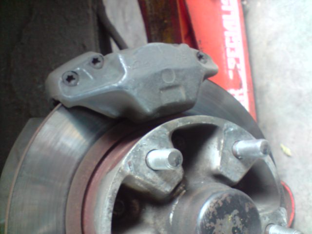

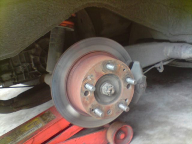

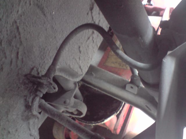

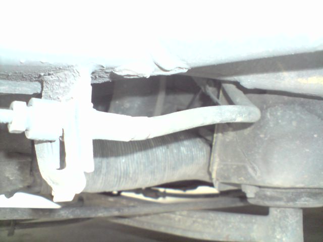

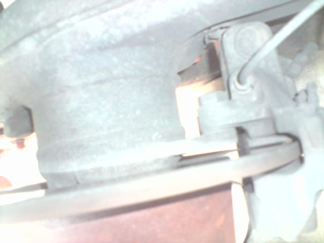

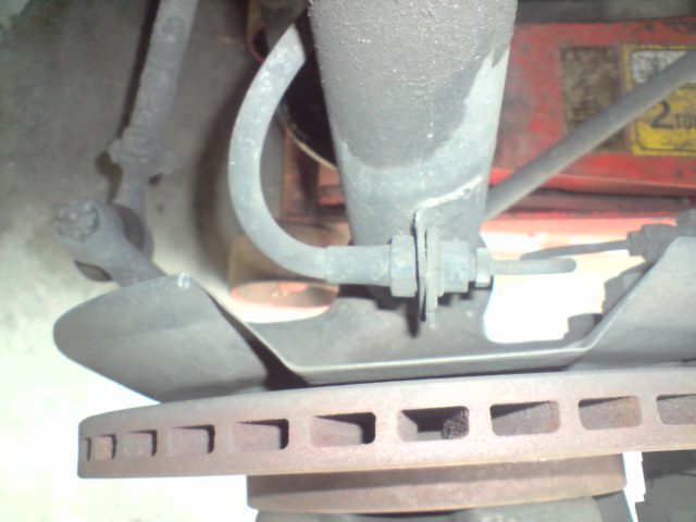

Hey guys, the brake lines in my 914 are buldging so i need to get new lines, my car is fitted with 5 stud rotors and brakes from a 911(so im told) so im not sure what lines i need to get, and i also need to replace the linings and not sure which ones to get. The brakes look to be the same as an early 911 or 912 but not sure if i should get 914 lines or 914-6 lines due to 911 brakes??
cheers any help would be great! Michael |
| mikeyboy_85 |
Oct 12 2008, 09:38 PM
#2
Member ![]() ![]() Group: Members Posts: 82 Joined: 24-May 07 From: australia Member No.: 7,758 |
here are some pics of the front and rear brakes and lines as fitted to my car, im pretty sure the rear are stock but redrilled for 5 stud, but the fronts im not to sure about, but im sure that u guys will be able to tell me from the pictures
cheers Attached image(s)
mikeyboy_85 What Brake lines to buy? Oct 12 2008, 07:11 AM
jimkelly post some pics and talk to eric shea
http://www.p... Oct 12 2008, 07:28 AM
Dave_Darling I believe the 914 flex lines will not have the cor... Oct 12 2008, 02:14 PM
mikeyboy_85 sorry bout bad pics, taken on phone Oct 12 2008, 09:40 PM
GeorgeRud Go with the same lines as you have. They should b... Oct 12 2008, 09:49 PM
mikeyboy_85 thanks mate! will get them from pelican parts Oct 12 2008, 10:22 PM
mikeyboy_85 can someome tell me what linings i would get for t... Oct 12 2008, 10:22 PM
Dave_Darling Those front hubs look like 911 parts to me! M... Oct 13 2008, 12:51 AM![]() ![]() |
