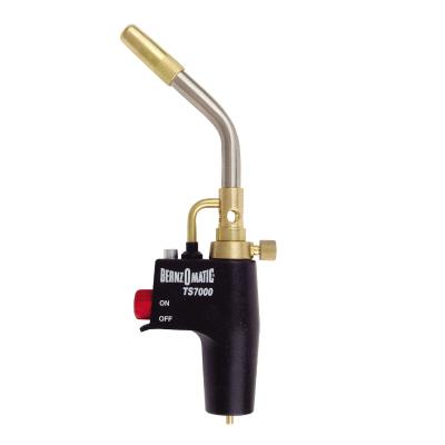

Map gas it just until it starts to form small bubbles then pop it off with a screwdriver. the heat will relase it and if it cools it won't reattatch but it won't break free from the surrounding bondo as easily as it will when still hot. Oh and do'nt catch it when it falls

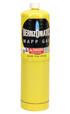

What is map gas & where do i find it?

Methylacetylene propadiene burns higher temp then propane, but for this use propane would be perfectly fine, the extra heat from Mapp isn't necessary. Lowes, HomeDepot etc sell them in small cans I would strongly recommend one of the torch heads with an ignitor button on it too.
